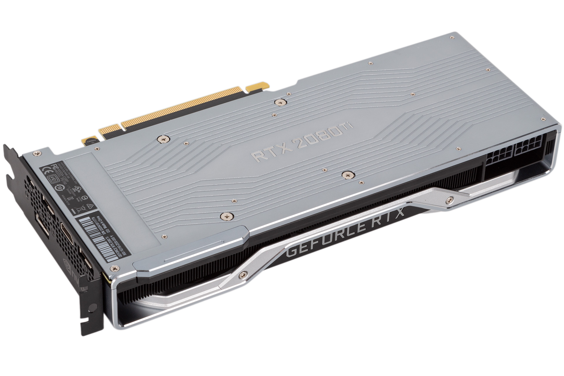

Warhammer aside, the RTX 2080 Ti is clearly a monster in traditional rendering workloads that inform our core benchmarking, and it easily claims the crown as the fastest gaming GPU. It really is a card that can tackle pretty much anything you care to throw at it, even at 4K and with all the settings cranked up. To be honest, the RTX 2080 is pretty much there with 4K too thanks to GTX 1080 Ti-like performance, but we’d posit that long-term it’s more suited to 1440p. Of course, choosing resolutions lower than these with the respective cards will allow you to take advantage of high refresh rate monitors.
Overall, there’s a 22 percent performance delta between the RTX 2080 Ti and RTX 2080 on average across our six games and synthetic workloads. Looking a little closer, we see the RTX 2080 Ti pulling away further at 4K, where it enjoys a 29 percent lead. The VRMark Orange Room scores are odd in how similar they are; we’re likely looking at a CPU limit here.
The RTX 2080 Ti also comes out as a whole 62 percent faster than AMD’s closest card, the Radeon RX Vega 64. It also consumes a little less power while doing so – it’s a stark gap.
Looking at RTX 2080 Ti versus GTX 1080 Ti, we see an improvement of about 25 percent, an average which again disguises facts like a greater difference at 4K (an area where Nvidia has vastly improved) and very significant performance gains (~40 percent) in our Vulkan title, Wolfenstein II.
The RTX 2080, meanwhile, is very close to the GTX 1080 Ti, with less than three percent between them overall. We also see an average of 1.3x performance of the GTX 1080, although as expected some workloads are much higher e.g. VRMark Cyan Room and the Vulkan-based Wolfenstein, while others are lower like Fire Strike and VRMark Orange Room.
Where previous Nvidia Founders Edition/reference cards were good when it came to cooling, that was always followed by ‘for single-fan cards’, a description that can now be accurately removed. Both new FE cards run not only cool (sub-50°C on a delta T value is great) but also quiet, indicating the effectiveness of the new cooling solution. While neither is silent under load, the difference between these and previous generation single-fan cards was immediately obvious. The fans on our RTX 2080 peaked at 53 percent (just under 2,000 RPM), while those on the RTX 2080 Ti were at 57 percent (about 2,125 RPM). When idle, they both drop down to 1,500 RPM, which registers as 41 percent.
Power figures are where we’d expect them to be. There haven’t been major efficiency gains in traditional shader workloads with this new architecture, but it is worth noting that the RTX 2080 does still consume a little less power than an overclocked GTX 1080 Ti, with which it mostly keeps pace in benchmarks.
With the overclocked RTX 2080 Ti and RTX 2080 consuming 64W and 56W more power than at stock respectively, the Turing parts clearly aren’t afraid to use additional power headroom. It’s not a particularly efficient overclock, as the former only improved in our benchmarks by between eight and 13 percent while the latter went up by between six and 11 percent: not great, but not bad.
